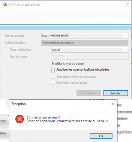

Here’s how I type in the infos in the ExportSample provided “as it” by Milestone:
I also tried with Name of the server instead of IP (with and without http:// prefix) but the output is the same:
First time I connect I have this error (in the picture) and the second time I try (without closing the ExportSample windows) it work, with same informations.

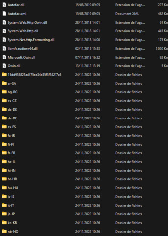

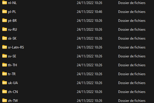

How do you deploy? Are you sure you get the full target folder (from your development build) copied so that you have the dependent dlls.
For deployment, I build my solution, and then extract all that it’s in my “bin” generated folder and copy all the content on the server.
Here are screenshots of all Dll + folder that is generated :
2022-11-25 10_09_58-Debug
