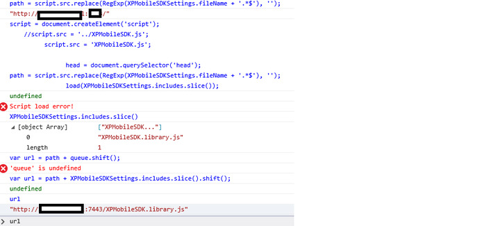

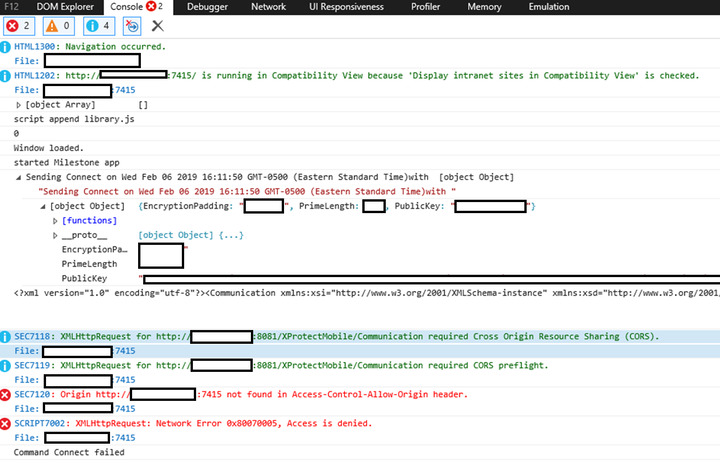

Attached image are edits in initialize in the sample video app.
Still returning script load error from 'http://ip:port/XPMobileSDK.library.js"
Thomas

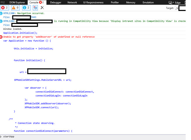

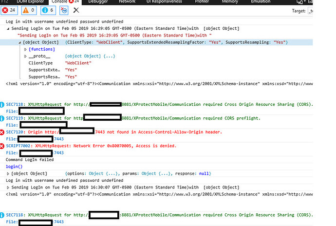

Including scripts XPMobileSDK and XPMobileSDK.library into the session through referencing in html head, loads the libraries into session. Then removing the load of xpmobilesdk.library in xpmobilesdk and xpmobilesdk in the edit to sample app leads to attached screenshot. Libraries load ok, however app doesn’t start. Any solutions on how to instantiate the app after the session loads please?
Thomas
Update,
Through loading the functions XPMobileSDK.library.Connection = new Connection(); and Login() after session loads, the following screenshot results. Didn’t enter credentials this round however error similar as the edit where credentials entered prior Login().

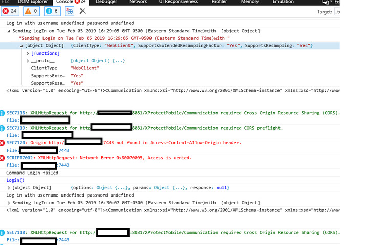

Update,

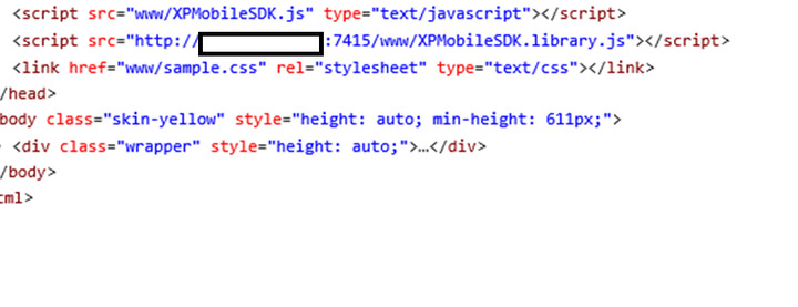

A couple attachments include screenshots ‘connectsOk’, ‘doesntConnectYet’, and the html head scripts.
All the libraries and functions loaded ok, and are visible through ip:port/www.
SDK is installed on the server other than the milestone management server.
Internet explorer login and connection to cams works ok on this remote server from local, no luck yet with loading the same app through ip:port in the browser on the same remote server however.
Same cors request error as before, however this time everything loads ok up to that point, no in console edit checking.
A similar cors request occurs from chrome browser in the sample.html that opens ok in internet explorer.

A lead at the moment is ‘command connect failed’.
Also I’m googling how to check if the ip:port returns ok for the cors request through another way. The ip is the same for the host name specified on the management server machine, which lead to the local html sample functioning ok in internet explorer.
Thomas

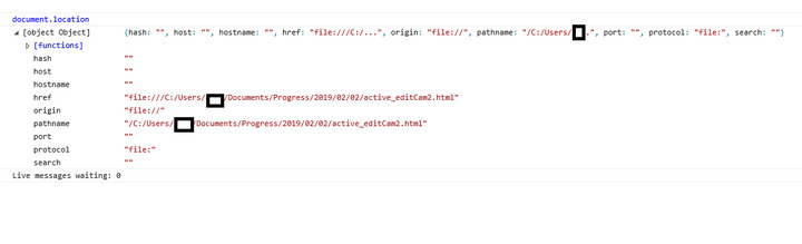

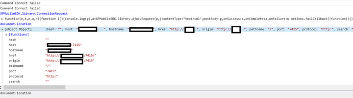

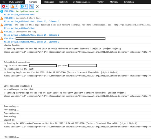

The first of the last two screen shots is console log out of document.location for the sample video web app that has the cors error on the remote server.
The second is the same sample web app from html file in directory on the remote server.
Before the CORS was configured on the Milestone management server, the html had the cors error, but after edit, functions ok from internet explorer.
Another note, login from html launched in ie browser from directory, has activex allow pop up that needs to be cleared before login prompt appears. In the ip:port version, the activex pop up doesn’t appear yet.
