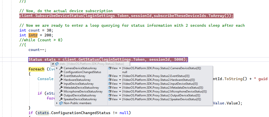

I have 4 recording servers connected to my 2025R3 Management Server, with a total of 20 camera devices. I modified the StatusDemoConsole sample project to obtain the camera states.

As part of the changes, all 20 cameras were added to the subscribeTheseDeviceIds list. However, after subscribing to the devices on the client side, only 8 cameras are being displayed in the CameraDeviceStatusArray. Please refer to the attached image for details.
Could you please confirm if there is any limitation on the number of cameras that can be subscribed to?

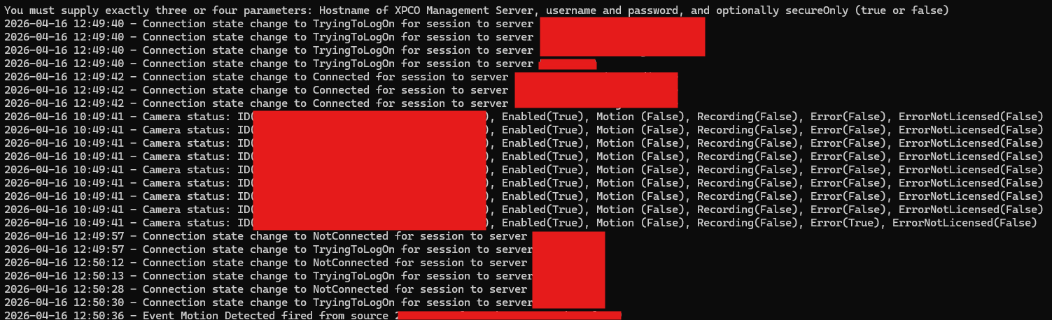

I have tested using the System Status Client Console Sample, but I am still receiving the status for only 9 cameras.
Additionally, the sample is unable to connect to one of the four recording servers. Could you please help identify the possible reasons for this connection issue?
Also, could you clarify why the sample is not providing the status information for the remaining cameras?
If you run the Smart Client in the same PC, can you see footage from all the cameras at all the recording servers? If you run the sample in the Management Server does the sample work better?
I am asking because it could be network, that you cannot communicate with the recording servers
