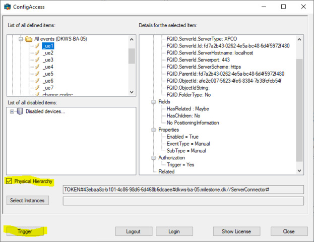

On how to trigger a User-Defined event is recommend exploring the Config Access via SDK sample and the trigger button in that sample.
https://doc.developer.milestonesys.com/html/index.html?base=samples/componentsamples/configaccessviasdk/readme.html&tree=tree_2.html
