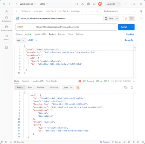

I cannot reproduce, for me it works..
https://doc.developer.milestonesys.com/mipvmsapi/api/config-rest/v1/#tag/Events/operation/postanalyticsEventsById
If you do a GET, do you get a good response or the same error?

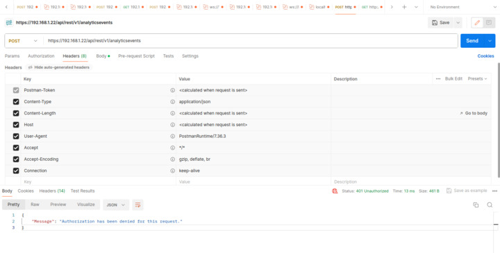

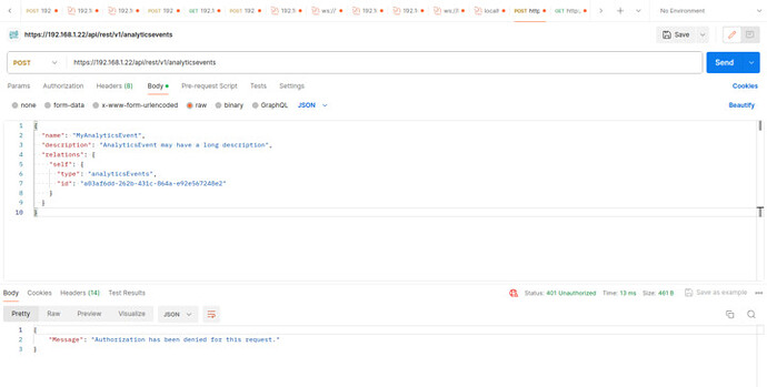

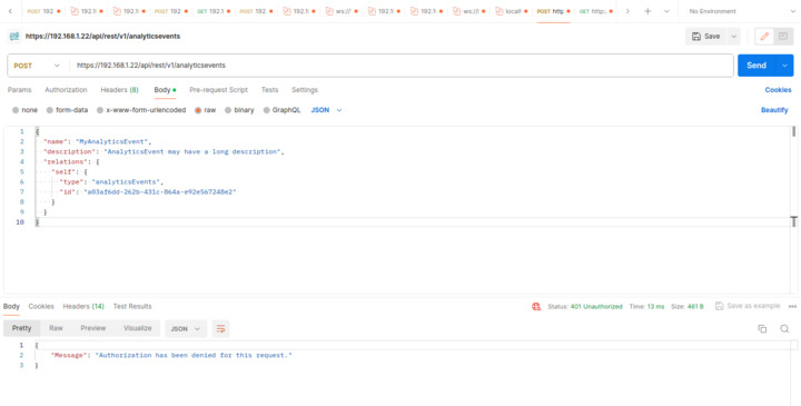

Thank you for your response. I tried to create a new analytics event for XProtect located at the address 192.168.1.22, following the steps shown in the visuals, but I’m currently receiving a 401 Unauthorized error. I’m unsure of why this issue is occurring and how to resolve it. Is there another parameter that needs to be added to the header of this request ?
I suspect you don’t have a token, please start here. https://doc.developer.milestonesys.com/mipvmsapi/content/quickstart/
