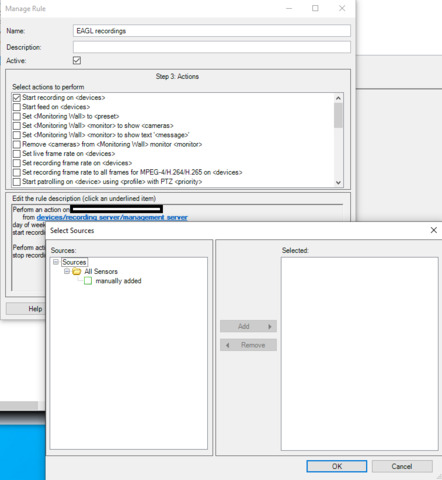

created items visible in the management client
Manually creating items:
Differences between manually created items and automatically created items:
Only manually created item appear as possible source for rule trigger events (using our custom event)
Only automatically added items appear when getting a list of sensor items:
// get all the sensors here
                                        List<Item> sensors = Configuration.Instance.GetItemConfigurations(EAGL_alarmDefinition.EAGL_alarmPluginId, _connectedEAGL, EAGL_alarmDefinition.EAGL_sensorKind);
This call would only return sensor 1 and 2 but not the manually added sensors.
I am confused about the difference in the backend between manually created items and items created through the Item Manager. Can someone give me some insight as to what might be causing the difference between the two items?

When comparing with the Sensor Monitor sample, in that sample you have Controllers and Sensors. Controllers don’t have parents, Sensors do.
When looking at your code we are guessing that you have Sensors without parent items, but in your code, you fill the parent when creating FQID and Item.
We think there is a mismatch here, and it goes both ways, the items will not list in the rules if there is an unknown or invalid parent, and in the GetItemConfigurations you ask for items with a certain parent which may be invalid. If you use parent null or guid.empty GetItemConfigurations might give you the item..
There is an element of guessing here. Hopefully our guesses are accurate enough for you to solve the issue. If this does not lead to a solution, try to go deeper into the comparison with the reference sample.
