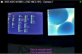

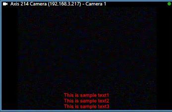

We have a String With multiple lines for each camera.
Sample: "This is sample text1
This is sample text2
This is sample text3
Now we are displaying these lines in a single bounding box with single text color.
What we actually want is Each Line in the string should be displayed with different colors.(line1:Red,line2:Green,line3:Yellow,..).
The number of text in the string are generated dynamically for each camera and based on the text the color have to be decided.
So the bounding boxes for each camera have to be differs in count and color.
How can we achieve this?
Here we have attached the screenshots of what we have done.
