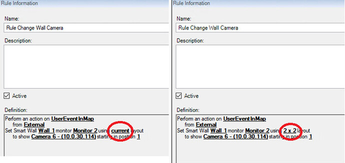

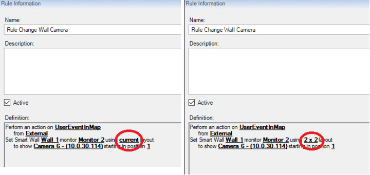

I assume thet same rule can be made manually in the Management Client, how does the rule look like?
Can you please share the snippet of code creating the rule so that we can directly reproduce the issue?
Sorry for the late answer.
So I’ve figured something else. The XProtect version I was working on was 2022 R1, and when I retested in a 2022 R2 version it didn’t have any issues to get the Item. So I guess it was patched up in the next MIP SDK version.
Anyway, here is what you asked:
  • The two rules side by side. The one on the left is the one who doesn’t let me get the item.
