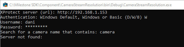

Component Sample CameraStreamResolution Result
Do you have a workaround for this?
Thanks,
Dani
Please note this line of code in the sample:
static bool _secureOnly = true; // change to false to connect to servers older than 2021 R1 or servers not running HTTPS on the Identity/Management Server communication
(CameraStreamResolution -Program.cs -line 26)
As the comment explains older servers do not have the secure functionality, and with the secure-only flag set it cannot work.
I hope this explains the issue you experience.
