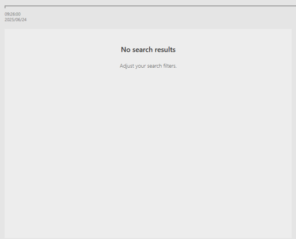

I noticed that the playback metadata is sourced from the built-in MotionAlarm rather than the ONVIF event that I would prefer to use from the camera. What steps should I take to obtain the playback for these specific events? When I access the hardware in the Management Client and click on “Events,” I see the data event topic that I want to create a search agent for. However, it does not generate playback entries in the "Search."Screenshot 2025-06-23 151721
Hi @Bo Ellegård Andersen (Milestone Systems)​ ,
During my testing with the MetadataPlaybackViewer, I confirmed that the desired metadata is being recorded; however, it does not appear in my Smart Client recordings.
Am I missing something?

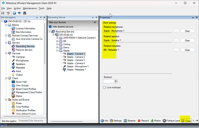

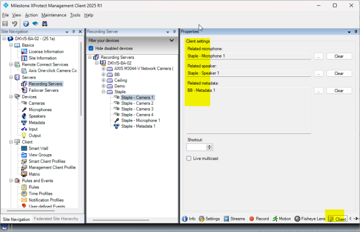

Is it possible to get the MetadataPlaybackData for a selected camera instead of using Configuration.Instance.GetItemsByKind(Kind.Metadata)?
When you have the camera item, then you find related devices like this…
var relatedItems = _selectItem.GetRelated();
Which items are related is governed by the setup seen here.
I think it is the same you use in the context of search agents…
