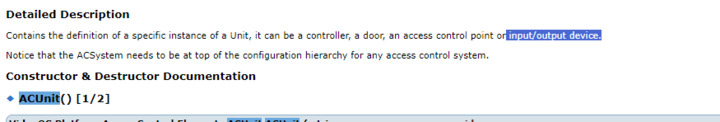

In the document it says ACUnit can be output/input so. If we wish to control these ACUnit in Smart Client, how should we implement the plugin?

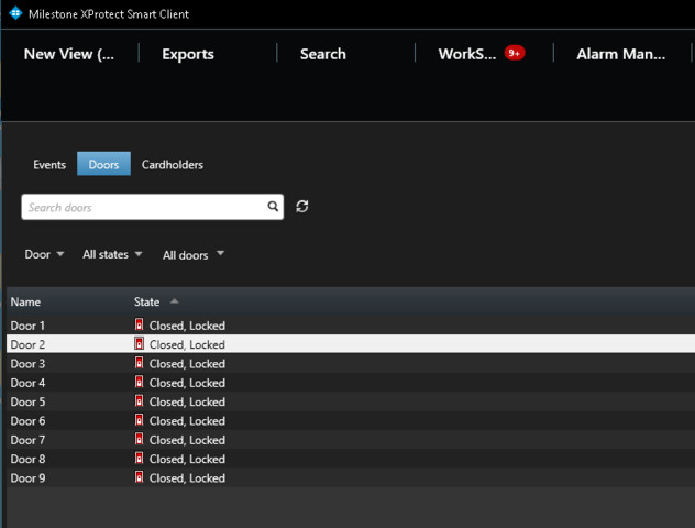

In Smart Client->Access Control tab → Doors, you can view the ACUnits (Doors, Access points and Controllers). Check image below…

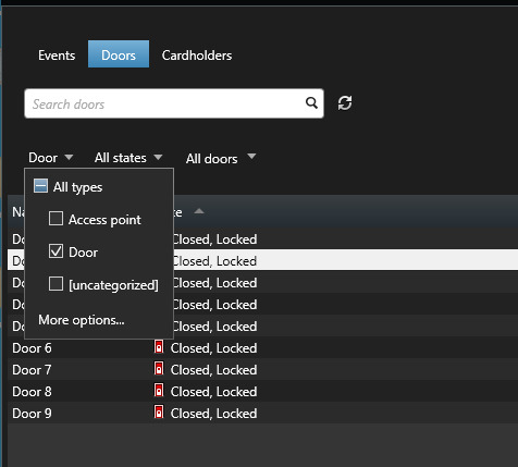

By default the view list is filtered to show just Doors. By clicking on the drop down menu you can customize the filter to show “All types” or some selected types. Check image below…
If you choose “More options…” option, you can view and select the types you need.

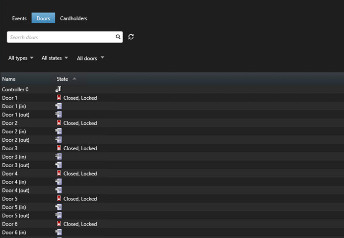

For example in the image below, you can see the view in my Smart Client after selecting “All types” option. I can view the ACUnits Input, Output, Doors and Controllers. But, you can only Lock/Unlock Doors and view related cameras for ACUnits.

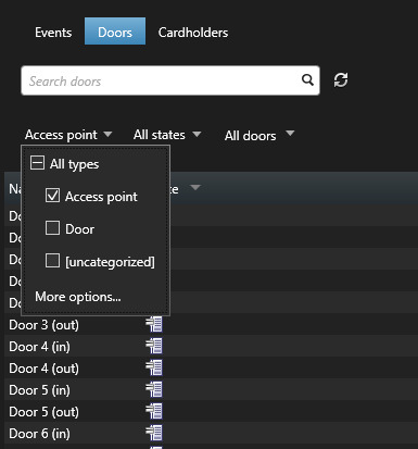

Left click on “All types” filter and select “Access point” from the menu. Check image below:
That would be enough to “show input/ouput within the Door tab”.
