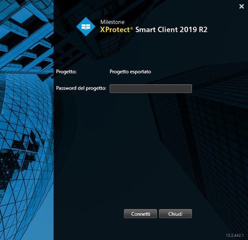

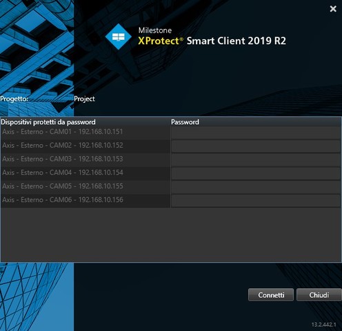

  1. Starting the Smart Client by clicking on Project.scp appears a window with the list of the 6 cameras and for each line I was asked to enter the password; the client for which I am developing the application wants to export all the cameras simultaneously which are 52 … it is not possible to enter the same password 52 times. On the contrary, if the video export is done via Smart Client, only one password is requested …

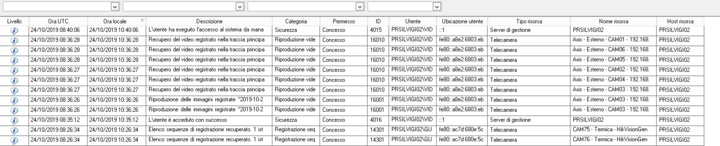

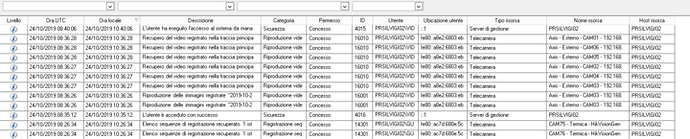

  2. My Client wants the operations carried out through the program to be recorded on the Audit Log, if I use my develop platform with 2019R2 the operations are recorded, as you can see (sorry for Italian, but also this is a Client’s request)
a
VideoExport is the App name and the records of the register are consistent with the operations carried out …
On the XPCO 2018R2 platform the App log messages are completely ignored without any error message …
There is only information on the recovery of the 6 cameras (AXIS) streams but not the log messages generated by the App … do you have any idea why this happens? my Client has Professional+ 2018R2

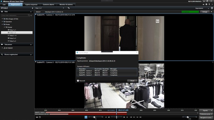

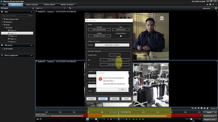

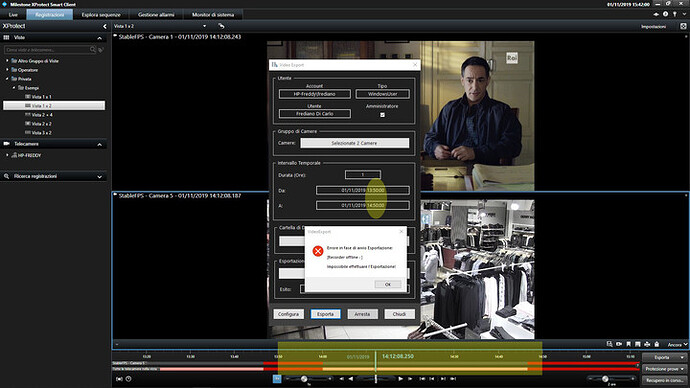

Looking at the Recording Server logs I understood why the export crashes; this happens because in the selected time interval some cameras (all StableFTP) have recording holes … here is the status of the recordings of cameras 1 and 5 …
If I repeat operation using only Camera 1, or reducing the time interval, the export is successfully carried out (with all operations logged). However, the same thing does not happen using the Smart Client procedure, the export is performed correctly with the playback containing the recording holes.
Any system with a large number of cameras may have registration holes, perhaps due to failure, so the procedure performed by the SDK is NOT usable …

A guess on (A2)
One possible explanation is that you do not have the same settings on logging. In the Management Client, Tools - Options, on the Server Logs tab, verify that the settings for Audit log is the same in the two systems.
A guess on (B)
The export should work even if there are periods with no footage, but it is known that it will fail if a camera has no recorded footage at all. Please check and comment on this.
(A1)
The observation on the requirement of entering the password multiple times, one for each exported camera, is something I will consult Milestone Development about. I will get back on this.

For B please look next image, it’s self explained …
This image is for A1 …
This is the export I take from XPCO 2018R2 … 6 passwords

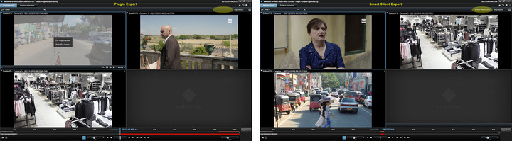

I have quickly rearranged VideoExport App in a plugin module and now it is almost working fine.
Next Image is after plugin exporting with recording holes …
… only one password …
… but exported recording are not signed!

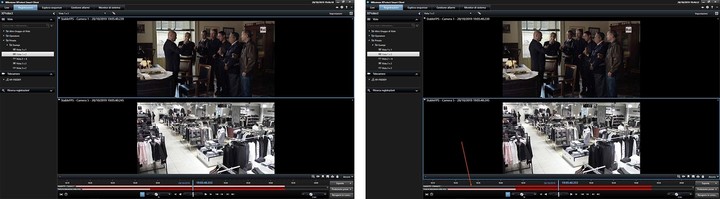

Next image shows players from plugin export and from SC export (same cameras but different time interval), as you can see in first case there are any indication on sign verify, do you have an idea why? It is very important to have signature
