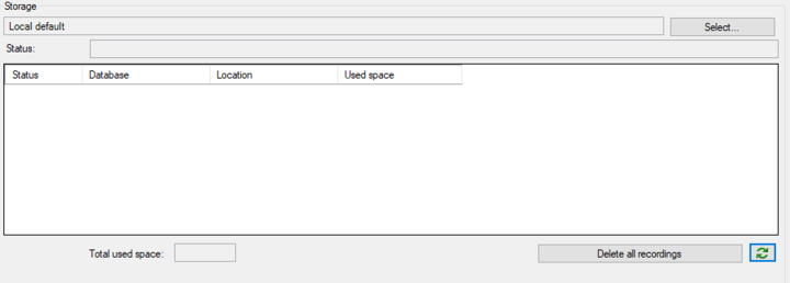

After some trial and error we discovered that the exception only gets thrown when attempting to export a camera that has no entry in the recording database. The camera was previously disabled, and after enabling it no entry was made in the storage area of management client as follows:

Even though there is no entry shown in the management client for the camera, I can see that the two folders for the camera (normal recording and EDGE recordings) have been created and populated on the recording disk.
