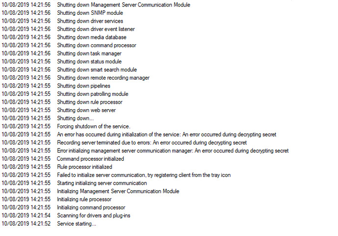

If I open the recording server with the startup arg “-x”, a window shows up. This window closes a couple of seconds after. How do I properly debug the recording server when I’m developing a driver?
Here’s the log:
