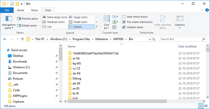

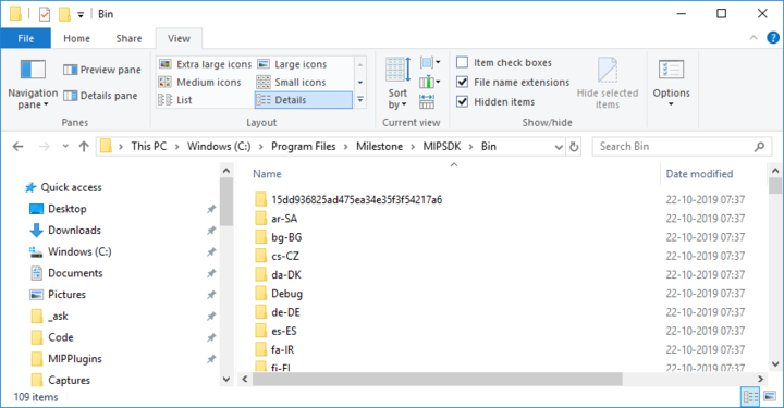

In MIP there should be folders including a “weird” named folder containing the software fallback decoder, it should start with “15… GUID like name” .. this must be present with your application as well if it should work without HA.

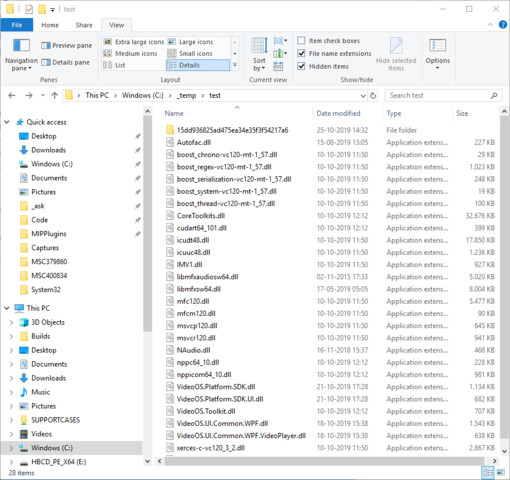

Looking at the MIP SDK Bin folder.
It is important for you to copy the folder without modifying it.
The recommended mechanism is to use the copy*.bat files to do the copy. I did a small test and it seems to work correctly, this is what I see when I have tried to use CopyUIFiles.bat to copy the files.

@Bo Ellegård Andersen (Milestone Systems)​, we tried replacing the folder within our app root folder and it works fine with H.265. Although we still need to test with more machines, it seems to be a feasible solution. Thanks a lot for your help.
