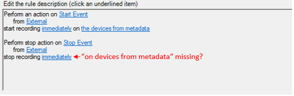

I created a plugin integration which provides events that can be used in the rule engine to e.g. start and stop recordings on cameras.
In order to specify the cameras to start the recording on I add the camera-FQIDs as reference in the triggering event definition (inside the plugin).
In the Management Client you can then use the “use devices from metadata” option to start the recording on the cameras specified as references in the triggering event.
For starting the recording this works fine.
For stopping the recording I created an event which also adds cameras as reference in order to stop the recording on these specific, referenced cameras.
Nevertheless the rule always stops recording on all cameras that have been started recording by this rule, independent of the referenced cameras specified in the triggering stop-event.
This behaviour goes as far as the stop event is triggered without any camera references definied but it still stops recording on any cameras which has been previously started recording.
As I’m taking a closer look into the rule definition there might be missing a “use devices from metatada” in the stop-action definition for stopping recordings.
Is there any way to only stop recording on cameras referenced in the stop event?

If you want to use Rules in Management Client, then it is impossible to do it. This is by design.
When a rule has a start action, this action must be reversed in the stop action. The rule system must be enforce this. For this reason, it is designed so that stop action is unconditional and cannot be on metadata.
when you start recording cameras by triggering a rule, the rule needs to stop all action.
