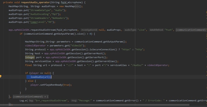

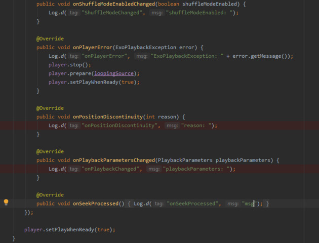

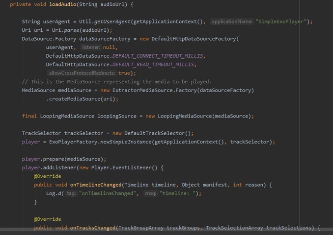

Krasmir, thanks for your help.
This is all the code I have for the audio implementation with exoplayer.
I use the audio properties that I saw in https://developer.milestonesys.com/s/question/0D53X00006INmfrSAD/are-there-any-live-audio-streaming-examples-for-the-mobile-sdk-now-that-support-for-this-has-been-added-in-the-2019-r3
I get fqid from the camera and with the SdkMilestone request AudioStream method I get the url that will generate the audio
Finally I use exoplayer code to generate the audio:
player = ExoPlayerFactory.newSimpleInstance(getApplicationContext(), trackSelector);
player.prepare(mediaSource);
player.addListener(new Player.EventListener() {
