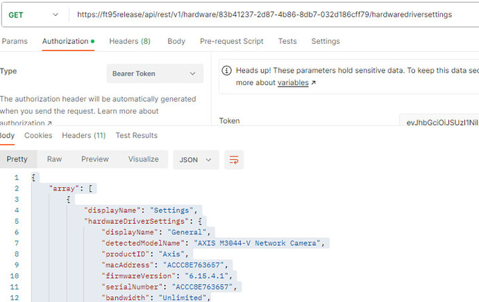

from the docs I see this example. So will there be another field in the array with the MAC address? At the same level as “hardwarePtz” like “macAddress”: “AA-BB-CC-DD-EE-FF” ?

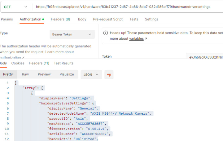

Because of the very high number of drivers that all offer different capabilities the documentation does not include all fields you can expect to receive. MAC address is however a field that should always be there. I made a simple test with Postman and this gave..
