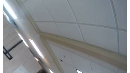

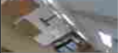

Hi, I’m experiencing differences in image quality between the he camera viewer from the Xprotect Mobile Web Client and the viewer sample in the MobileSDK. On the Mobile Web interface, the camera image quality seem fine and clear. However, using the sample provided in the MobileSDK, the sample viewer gets blurry often. Event when setting the compression level to 100, I am experiencing the same behaviour.
Is there a difference between how the Mobile Web Client and the MobileSDK samples decode the received frames? Or is there a setting I am missing when requesting the video stream in the samples?
