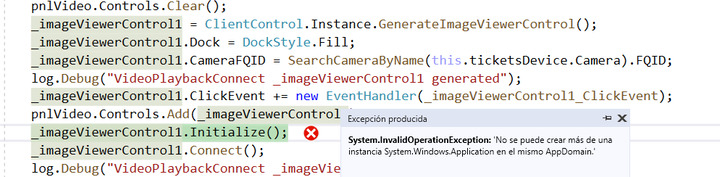

We have an application that you can select the camera/recording an launch another window in order to play it.
The second window contains an imageControlViewer, the user can create multiple windows with different camera/recordings information but when a window has been created and closes the new one has an excepction at imagecontrolviewer.Initialize() saying: Can’t be created more than one instance System.Windows.Application at the same AppDomain.
en System.Windows.Application..ctor()
en VideoOS.Platform.SDK.UI.DirectX.ImageViewerDirectX..ctor()
en VideoOS.Platform.SDK.UI.SDKImageViewerControl.Create()
en VideoOS.Platform.SDK.PlatformImageViewerControl.Initialize()
en MKVTransact1.frmSearchDirect.VideoPlaybackConnect() en C:
How the imageViewerControl has to be manage to work in multiple windows?

Hello,
I have the same issue. I try to explain better what I found. In our software ImageViewControl is opened on a pop-up window. You can open several instances without any problem. If you close all popup and re-open a new instance, it fail with the exception.

After some investigation I discover that the issue appear only in debug in Visual Studio 2019. Launching exe directly or in Visual studio 2017, it works correcly.
I am having exactly the same problem using the 2019R2 SDK and Visual Studio 2019, also only when debugging. I open a form and create an ImageViewerControl, show a camera feed in the ImageViewerControl, close the form (with the OnClose cleanup code), then do the same thing again, and when Initalize() is called the second time I get this:
An unhandled exception of type 'System.InvalidOperationException' occurred in PresentationFramework.dll
Cannot create more than one System.Windows.Application instance in the same AppDomain
Any plans on a fix for this?
After a closer investigation it was found that there is an issue that can be experienced while debugging ImageViewerControl using Visual Studio in the 2019 version.
Milestone Development has changed the ImageViewerControl implementation so that the debugging issue with Visual Studio 2019 will not occur in future versions of the MIP SDK.
MIP SDK 2019R3 will include this fix. MIP SDK 2019R3 is planned to be released in October. (Plan is subject to change without notice.)
