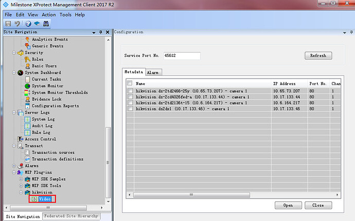

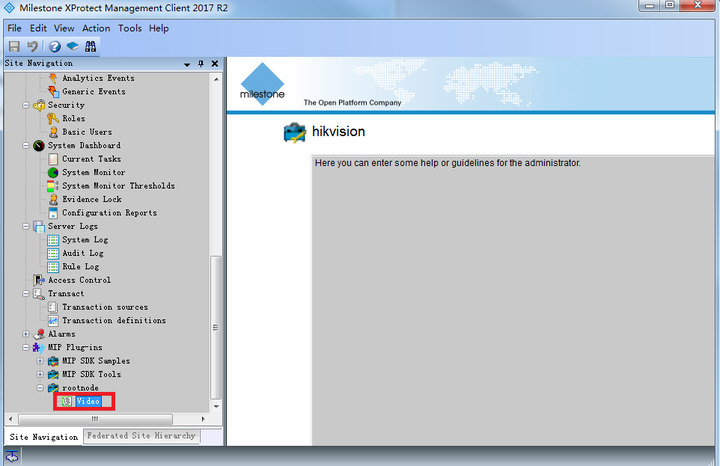

I created a project by reference to sample Chat, but if I click rootnode first,then the content for Video will not be displayed:

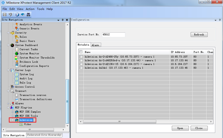

and if I click Video first, whether I click Video or rootnode later, only the Video content displayed:
Can you give me any suggestion? I just want to display the correct content with the rootnode/Video, and click sequence independent
