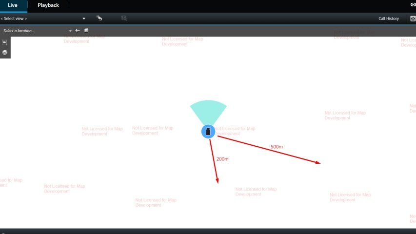

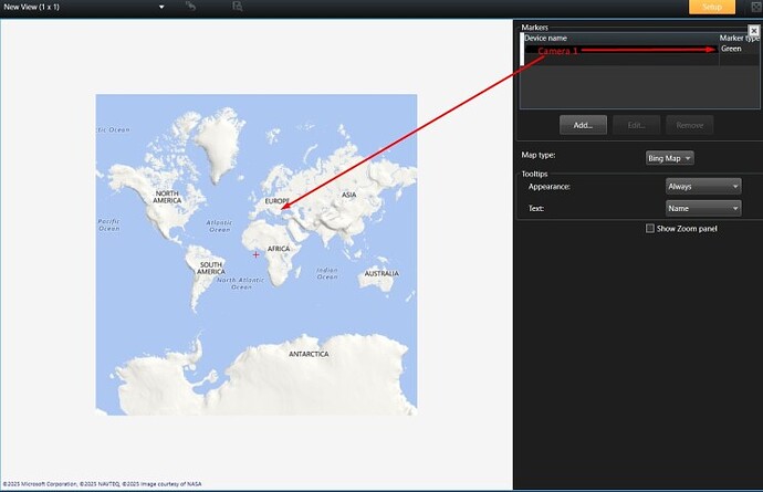

What I wanted in Milestone is to achieve a functionality like to display an arrow on the map pointing from the camera towards the direction from which the sound is coming, something like below image. on dynamically configuring multiple camera on a Map and show direction from cameras towards an arrow from where sound is coming. So, the process should be like first mapping a camera on a Map and on view & then once camera observe any sound near by we can see the sound direction from camera. Shown example in image 2(Not exactly but similar of this we wanted in a view with arrow or box or eclipse with distance).
The sample you suggested Location view is static view of showing camera on map with static data of longitude and latitude with Marker.
Where also I see that sample it was just adding camera to grid but can’t add on map shown in First image.
Image 1:
Image 2:
What I meant to say, is that you can make your own maps, but maybe the Smart Client Location View plugin sample wasn’t a good example in that it will not do what you require.
The built-in Smart Map cannot do what you require.
