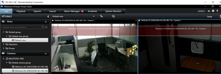

We have uploaded our sample application and Screenshot on which we are getting same Metadata Bounding Box which is generated for 1 Camera but its visible on both cameras.

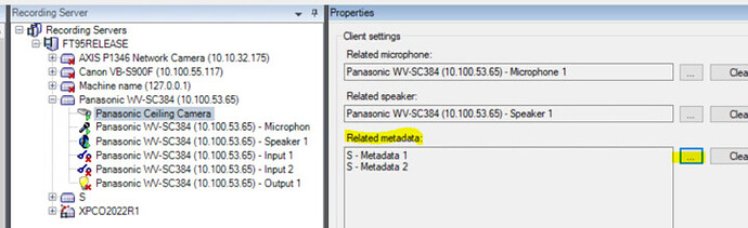

Can you please check if you set related to the device in Management Client? Start Management Client – select Recording server – select a camera – click Client tab and see Related metadata. You need to set it up to cameras, please see below:

We are able to get the Metadata Bounding Boxes on the cameras by configuring on Client Tab, but issue we are getting Bounding Boxes on all the cameras on which MIP Driver are added. We want Metadata Bounding Boxes to be displayed on particular camera to which alarms are generated.
This is how metadata works in XProtect, metadata is used in every camera that is setup to use it.
If you want different overlay for each of 100 cameras, you will have to make 100 providers.
Alternatively, you should not use Metadata providers, but instead develop a plugin that can show Alarms as overlay instead. If it sounds like the right direction, please try to explore the SCOverlayGraphOnEvent sample. https://doc.developer.milestonesys.com/html/index.html?base=samples/pluginsamples/scoverlaygraphonevent/readme.html&tree=tree_1.html
