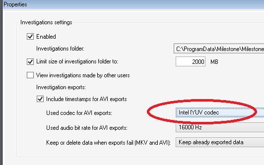

Hi Zhao,
In the Mobile server configuration MIP plug-in of the Management Client can be configured which codec to be used for the AVI export:
By default IntelIYUV code is used, which uses no compression.
Therefore file size is so big.
You can try with Microsoft Video 1 (which is supported on all the Windows OSes).
Also you could try to install third party codec on the Mobile Server machine (restart Mobile server, restart Management client and select it in the drop-down list).
If I remember well codec should have DIrectShow wrapper in order to appear in the list.
Codecs like “XviD” will provide high compression but for the price of time - you will have to wait for export preparation.
Another possibility is to be created MKV export instead of AVI one. If the camera original encoding is H.264, it will be packed into MKV container, without any trans-coding thus saving both time and disk space.
Of course only if MKV file is appropriate for your needs afterwards.

By the way, How can I open this setting dialog?
