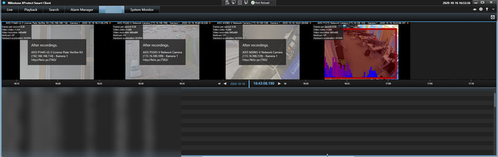

Hi I’m working on a dynamic viewlayout for 2-6 cameras that are supposed to stack horizontally however I’m getting some unexpected behaviour from the ImageViewerWpfControl. My current setup is a grid and then dynamically create gridcolumndefinitions with ‘auto’ width and then assign a imageviewerwpfcontrol to that column.

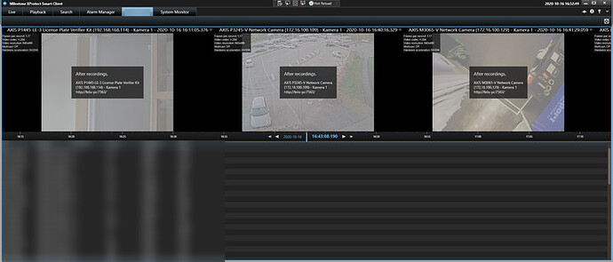

This doesn’t work because when I resize the window vertically the grid acts like a stackpanel and the 4th camera ends up outside the grid.

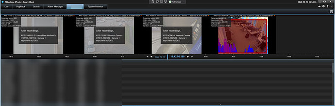

Yeah, that’s what I’m doing but I’ve tried it using different (native)controls within the grid and they behaive as expected. The ImageViewerWpfUserControl is very different and will expand outside the grid if the height is big enough. Try it yourself:

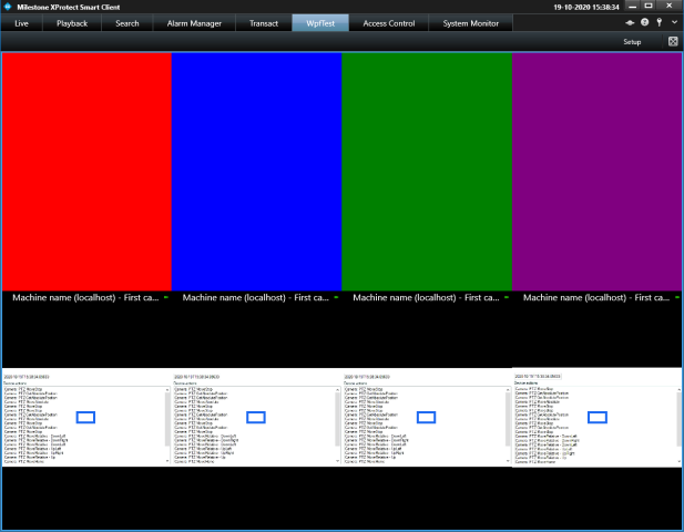

I think there is something I don’t get. I just tried creating a new plugin using the template and added your XAML from above to the WPF usercontrol and stripped down the workspace to online contain this and I get the following which scales up and down without problems, so I guess I am misunderstanding something?

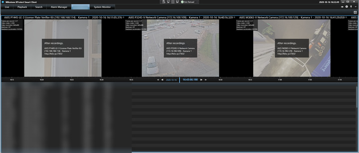

I inspected the host grid and it seems like the rendered width isn’t changing when I resize the window.
