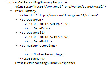

GetRecordingSummary
GetMediaAttributes returns noting for the requested time: 18:56:34. Which is normally correct.

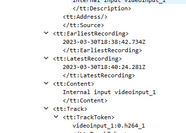

GetRecordingSearch returns a list of RecordingInformation for each clip range.

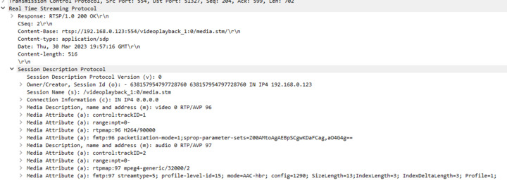

The RTSP session stops to DESCRIBE and the whole process is looping on those calls.
I attached a wireshark capture showing the conversation between Milestone and our device.
Could you help to understand what is going wrong.

I recreated the condition with new clips and I have the same issue. I attached the capture and the logs as requested.
I see an error saying Track not found, but the DESCRIBE contains both tracks.
EDIT: I see now that you have a working situation with the same device and the issue is intermitent. Will check more.
Original Post:
You are missing the x-onvif-track tag in the SDP. We need this to match the SDP tracks to the tracks in the recordings.
