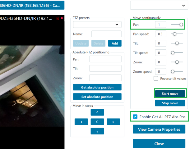

Here is the modified sample, perhaps you will have more luck in your environment.
There is a checkbox to start polling the PTZ positions from ALL the cameras (not filtering by PTZ to have better chance to try and break it).
My guess at this point is that some device(s) on the customer site is slow to reply to the get absolute postion and perhaps that could be slowing down all the other commands?
To run the test, choose an actual PTZ camera, enable the new checkbox, and modify the Pan from -1 to 1 and click start after each time you change the pan value. Even without using the stop command, you should be able to send multiple start commands in a row in different directions and the camera will cooperate.
