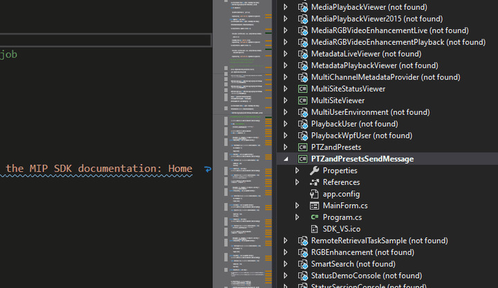

I reproduced my issue (see the attached 20210326_Duplicated PTZCenterCommand sent reproduced in Milestone SDK sample.gif) in one of the SDK samples (see the attached PTZandPresetsSendMessage.zip). The issue can be simply overcome in both SDK 2018 and 2020 by either:
- registering to RightClickEvent instead of ClickEvent (_imageViewerControl.RightClickEvent += this.OnClick;)
- setting EnableMouseControlledPtz to false (_imageViewerControl.EnableMouseControlledPtz = true;)
Unfortunately setting EnableMouseControlledPtz to false does not help in my product. Still, it worked fine when SDK 2018 was used.

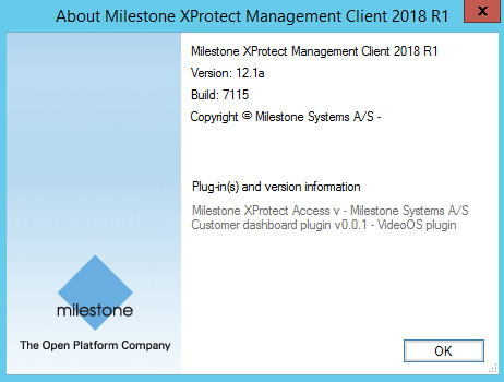

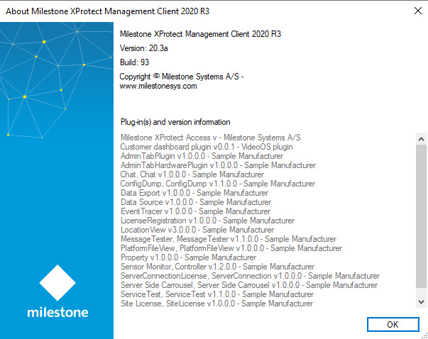

May I ask you one more question? Which product and version of the XProtect VMS are you using?​
SDK version: 2020.3.77.1
We reproduce the issue on both 2018 R1 and 2020 R3 XProtect Corporate systems
