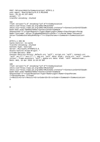

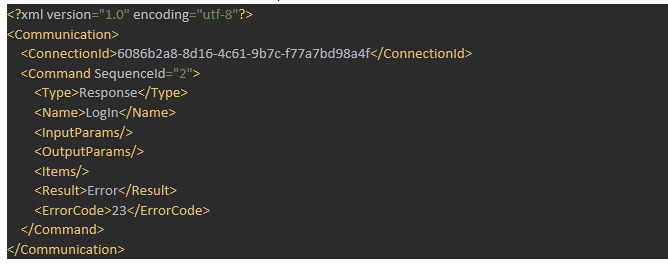

The login seems to be successful, but we are not getting a successful login response:
Result received from Mobile Server: Error 23
Definition of Error 23 in the documentation: “Not allowed in current state”,):
The Web SDK provided is working, and there’s no difference in the Mobile Server logs between the working and not-working integration.
What does error 23 mean? How can we solve this problem?

Attached is a Wireshark trace, requests are sent from Java (why does it matter?)
In any case, it should be helpful to understand the meaning of error 23.

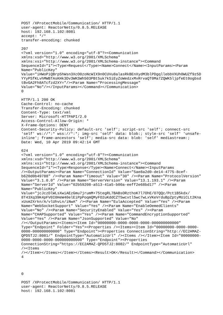

Okay,
could you provide wireshark trace in case of fail, please?
ok,
please find it attached.
br
In the second trace I do not see “Connect” command before the “LogIn”.
Is it sent ?

Yep,
Generally two cases:
  1. Sending LogIn wtihout sending Connect;
  2. Sending LogIn after completion of another successful LogIn;
(Probably also and sending LogIn without completion of previous Login)
In all the cases this error code indicates error in the workflow.
The command which is send is not expected in this time / order.
Hi Petar,
regarding your question:
the second case is probably happening because on wireshark we can see 4 requests instead of 2 where the final responds returned to the Java client is the error response.
We need to investigate why and where is it happening that we see 4 requests instead of 2.
Do you have an idea, why this could happen?

Hi Petar,
we fixed the problem. It was the second case. We used a not appropiate component and we tryed to login, but we were already logged in.
Br
