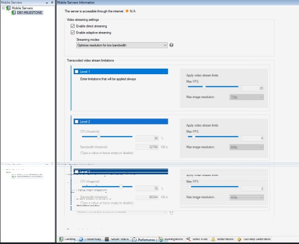

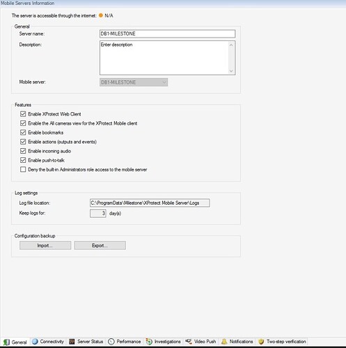

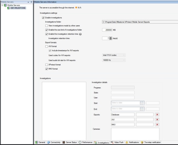

Hi, we have an application and sometimes when we are trying to download file from mobile server we have “Error getting export download link”..
Here our calls:
callbackAfterRequest @ Connection.js:2612
getExportCallback @ Connection.js:1734
parseResponse @ ConnectionRequest.js:147
onSuccess @ ConnectionRequest.js:115
checkReadyState @ Ajax.js:45
XMLHttpRequest.send (async)
Request @ Ajax.js:64
initializeAjaxRequest @ ConnectionRequest.js:78
connectionRequest @ ConnectionRequest.js:37
Connection.sendCommand @ Connection.js:2654
Connection.getExport @ Connection.js:1727
getExport @ XPMobileSDK.js:1384
(anonymous) @ wsMilestoneClient22.js:575
logger.js:6 Error getting export download link
error @ logger.js:6
and the mobile server logs
2024-08-02;12:55:27 PM;Info;MipSdkWrapper.GetCurrentServerConfiguration();Settings has been found.
2024-08-02;12:55:27 PM;Info;Main thread;Current Culture: en-US
2024-08-02;12:55:27 PM;Info;Main thread;Current UI Culture: en-US
2024-08-02;12:55:27 PM;Info;InitFromConfigSettings;outgoingAudioEnabled is True
2024-08-02;12:55:27 PM;Info;InitFromConfigSettings;incomingAudioEnabled is True
2024-08-02;12:55:27 PM;Info;LicenseWrapper;OnlineExpiration is True
2024-08-02;12:55:27 PM;Info;AlarmSecurityManager.TryRefreshUsers;All users list updated.
2024-08-02;12:56:16 PM;Info;LicenseWrapper;CheckTwoStepVerification is True
2024-08-02;12:56:20 PM;Info;LicenseWrapper;CheckBookmarks is True
2024-08-02;12:56:20 PM;Info;LicenseWrapper;ManageAlarms is True
2024-08-02;12:56:29 PM;Info;PlaybackVideoSourceExt.VideoFetchThread;Exitted
2024-08-02;12:56:40 PM;Info;PlaybackVideoSourceExt.VideoFetchThread;Exitted
2024-08-02;12:56:40 PM;Info;VideoChannelOut.ProcessSourceResolution;Source resolution changed to: 1920 x 1080
2024-08-02;12:56:46 PM;Info;PlaybackVideoSourceExt.VideoFetchThread;Exitted
2024-08-02;12:56:48 PM;Info;PlaybackVideoSourceExt.VideoFetchThread;Exitted
2024-08-02;12:56:49 PM;Info;VideoChannelOut.ProcessSourceResolution;Source resolution changed to: 1920 x 1080
2024-08-02;12:57:40 PM;Error;CommunicationManager.ProcessCommandGetServerStatus;Object reference not set to an instance of an object.
2024-08-02;12:58:32 PM;Error;MetaChannel.ProcessCommandCreateExportDownloadLink;Object reference not set to an instance of an object.
2024-08-02;12:59:47 PM;Error;MetaChannel.ProcessCommandCreateExportDownloadLink;Object reference not set to an instance of an object.
2024-08-02;1:00:29 PM;Info;PlaybackVideoSourceExt.VideoFetchThread;Exitted
2024-08-02;1:00:30 PM;Info;PlaybackVideoSourceExt.VideoFetchThread;Exitted
2024-08-02;1:00:30 PM;Info;VideoChannelOut.ProcessSourceResolution;Source resolution changed to: 1920 x 1440
2024-08-02;1:00:31 PM;Info;InitializeFromSiteItem;Server sub type: 600, Code base: 2, Version string: 23.1.0.1
2024-08-02;1:00:31 PM;Info;LicenseWrapper;Login is True
2024-08-02;1:00:31 PM;Info;MipSdkWrapper.CheckSettings();Number of read configurations: 1
2024-08-02;1:00:31 PM;Info;MipSdkWrapper.GetCurrentServerConfiguration();Settings has been found.
2024-08-02;1:00:31 PM;Info;Main thread;Current Culture: en-US
2024-08-02;1:00:31 PM;Info;Main thread;Current UI Culture: en-US
2024-08-02;1:00:31 PM;Info;InitFromConfigSettings;outgoingAudioEnabled is True
2024-08-02;1:00:31 PM;Info;InitFromConfigSettings;incomingAudioEnabled is True
2024-08-02;1:00:31 PM;Info;LicenseWrapper;OnlineExpiration is True
2024-08-02;1:00:32 PM;Info;AlarmSecurityManager.TryRefreshUsers;All users list updated.
Any suggestion ?
Thanks

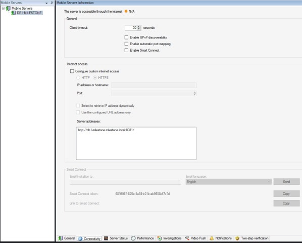

Immagine WhatsApp 2024-08-02 ore 10.28.26_f34cab1b
Hello!
looking through your post everything in the settings seems to look fine, as this error only happens sometimes it could be a timing issue, when you try to get the download are you sure the export has finished being created? if you look at the mobile server for the investigations is the files there ? if yes, could you try to tell me the specific steps you did next time you get this error?
