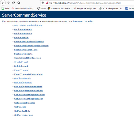

Can you please try this URL ?
http://{host:port}/ServerAPI/ServerCommandService.asmx?singleWsdl
Hi, It works,
I received a list of requests and responses,
But, How do I get a wsdl file?
Thank you a lot,
