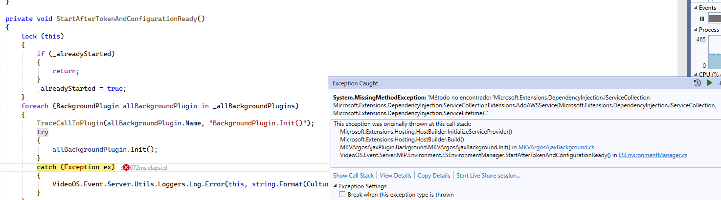

I want to integrate an AWS.SQS service (to get notifications) into a plugin. I have tried the same code into an .net Framework application 4.8 but when I add it into the Init of the Background plugin I get this error:
System.MissingMethodException ‘Microsoft.Extensions.DependencyInjection.IServiceCollection Microsoft.Extensions.DependencyInjection.ServiceCollectionExtensions.AddAWSService(Microsoft.Extensions.DependencyInjection.IServiceCollection, Microsoft.Extensions.DependencyInjection.ServiceLifetime)’.

Thank you for your answer, I have a post-build event to copy both the .def and the .dll file. I have also checked that without that part of the code the plugin goes through StartAfterTokenAndConfigurationReady() without any problem but with the code I get:

You say the dll file, in your case it must be multiple dll files, you should have also something containing the AWSService.
If you explore the RGBVideoEnhancement sample it is deployed with two dlls, in this case it something built by the plugin samples solution, in your case it would be a third party component.

When you use third party libraries, they must be working in .Net Framework, the current version Smart Client uses 4.7.2. You must then place the dlls that the third-party libraries use in the plugin folder, same place as you deploy the plugin dll itself and the plugin.def file.
Please note, that you should not mix .Net Framework and .Net Core, we are not sure whether you are doing this, but if you are it could explain your issue.
That is all that there is to it, and I hope this information lets you solve the issue, because I don’t think there is much else, I can think of.

Thank your answer. I think it is a problem with AWS and it could not be compatible with the Framework 4.7.1, I’ve thinking on another approach, maybe it is a crazy idea:
