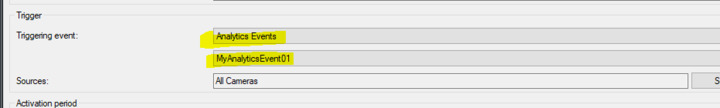

1 – What kind of event are you using? User-defined event or Analytics Event?
2 – “also a rule to create an Alarm from that Event.” Does this mean that you create Alarm definition?
If so, what do you select as Triggering event in the alarm definition?
Also, it would be great if you could disable rest of alarm definitions if you have multiple.
3 – And maybe you trigger the event with clicking “test event”, is it Analytics event?
Above questions might be a bit redundant, but to make the things clear is very important for reproducing the issue.
