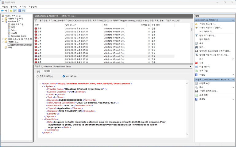

Looking into the logs of the event viewer, I found dozens of the same error message as following:
which means The maximum message size quota for incoming messages (65536) has been exceeded. To increase the quota, use the MaxReceivedMessageSize property on the appropriate binding element.

2025-08-22 15:13:48.203+02:00 [    50] ERROR      - SystemMonitorStatePusher      For (1) time(s) - The maximum message size quota for incoming messages (2097152) has been exceeded. To increase the quota, use the MaxReceivedMessageSize property on the appropriate binding element.
We have an theory that the issue is that you are sending a very large chunk of data, in this case the status object. That the chunk of data exceeds 2 MB.
