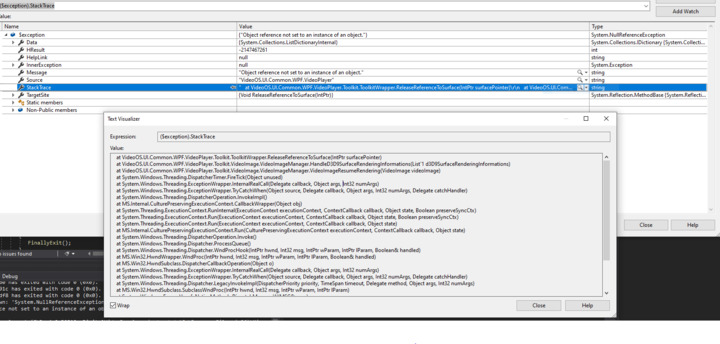

I occasionally get the following error stack trace when either opening or closing the ImageViewerControl.
I do not know exactly how this occurs however. I see this happen occasionally and it is unclear how it happens. What we are doing is performing some stress tests that will create a new ImageViewerControl and connect and display video and then after a few seconds, disconnect/close it, and immediately create a new one and connect to the same video. Perhaps it has something to do with constantly trying to re-create the same video over and over again too quickly? Can you please advise?

I did find the cause of the exception and it appears to be because of the call: imageViewerControl.Close(). If I do not call that when disposing of resources, I don’t get that exception anymore. Even after not calling this, I do not notice any resources being left over.
We have looked further into the code and this is clearly a problem on our side, and we honestly don’t believe the right solution is to stop calling Close(). For now the best you can do is to reuse the ImageViewerControls instead of disposing and creating new, but the team has also started looking into how to fix the problem, and we hope we can have a preliminary version ready within a few days, which we then hope you will test for us? If it solves the problem the next step will of course be that we provide an official hotfix.
