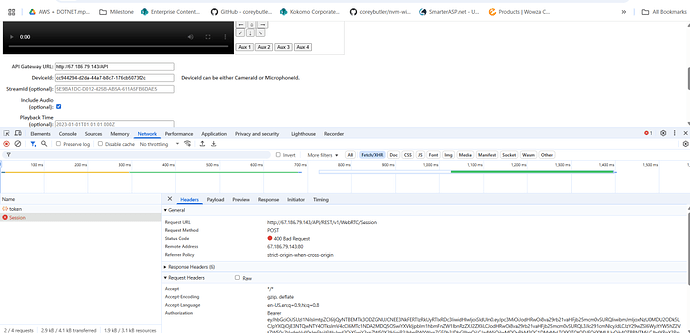

Hi
I got the token successfully from API/IDP/connect/token API after that we are calling /API/REST/v1/WebRTC/Session an here we are getting exception.
I am using milestone web socket for live video streaming.

This seems like a permission issue.
Could you verify that a user with admin permission can see the stream, just to rule this out?
If the user have read and view live permissions for the camera, the feed should start. Can you check that the user have these permissions?
