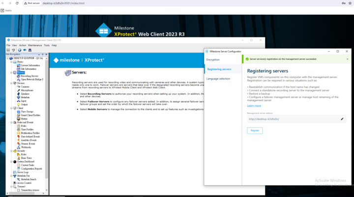

Hi,
I found a wired status. I can’t find the mobile server from management client. But I can open from web client and I did register for the mobile server service.
Is there any other configuration I can do ? Thank you.
You need to install Mobile Server administrative plugin on the machine where Management Client runs
https://doc.milestonesys.com/latest/en-US/standard_features/sf_mobile/mobs_xprmobileexplained.htm?tocpath=XProtect%20Mobile%7CXProtect%20Mobile%20server%7COverview%7C_____2
KR,
Svetlana
Hi,
It’s resolved, thank you.
