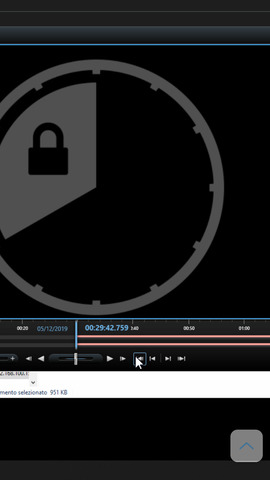

a couple of month ago, when exporting a period of time (i.e. from 00.00 to 00.00) the first hour of record wasn’t show image, but only this clock with a locked portion.
