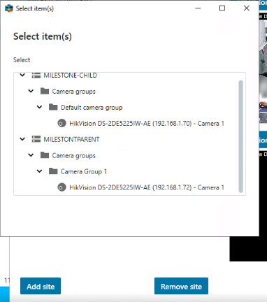

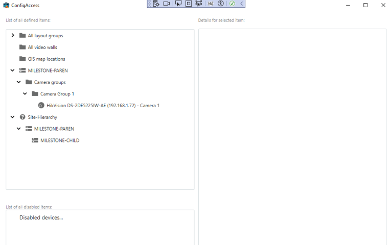

In order to achieve this, initially we are trying to discover cameras from all the nodes. We have tried the component samples like MultiSiteStatus viewer and ConfigAccessViaSDK, here we are able to discover the parent site cameras and the connected Child Site. But we are unable to access the cameras attached to the child site. The Child site item returns zero children. Please find the below screenshot showing this.

Please change the ConfigAccessViaSDK sample in this way.. (App.xaml.cs line 36)
loginForm.MasterOnly = false;   // Add this to login in MFA
loginForm.ShowDialog();

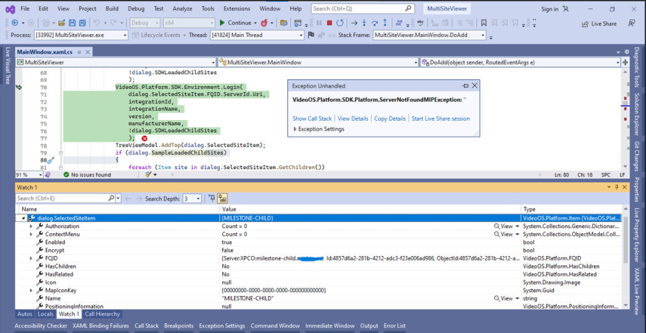

a. ‘Sample loads all child sites’: I get a VideoOS.Platform.SDK.Platform.ServerNotFoundMIPException when there is an attempt to login to the child site. This is the output from the debug logs:
"ConnectionCheck for:http://milestone-child.xxxx.net/, Took:10ms
ConstructLoginServer: Unable to identify server type:milestone-child.nuvteq.net
Exception thrown: ‘VideoOS.Platform.SDK.Platform.ServerNotFoundMIPException’ in VideoOS.Platform.SDK.dll
An unhandled exception of type ‘VideoOS.Platform.SDK.Platform.ServerNotFoundMIPException’ occurred in VideoOS.Platform.SDK.dll"

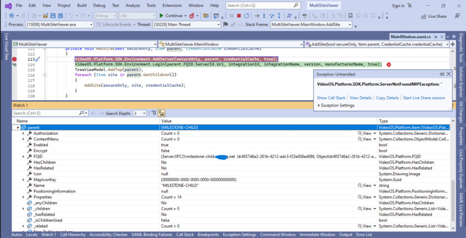

b. ‘SDK loads all child sites’: I get a similar exception as above ServerNotFoundMIPException when app tries to login to child site.

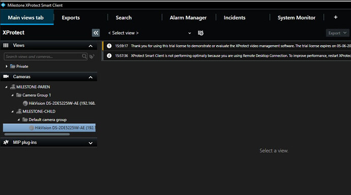

3. When we open the the Smart Cient on the master site, we are able to see the cameras of the child site on the Cameras list.
