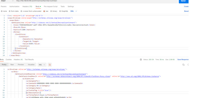

Hi,
We tried the filter parameters in our scripts but its doesn’t filter and yet return all the available alarm in the system. We didn’t get any error message.
From your screenshot it seems like you are querying all alarms for which LocalId NotEquals 3338? That would return most of the alarms in the database (except maybe one), so not sure I follow?
Hi Peter,
Yes. But in the result we still getting LocalID 3338.

Hi Carlos,
We tried to filter using only the Alarm → LocalID without the date. But the filter doesn’t seen like working. It still return all the alarm.
Thanks.

Hi,
May I know the code that we applied on the filter is it correct in SOAP?

Apologies for replying so late, I have been away till today. The current filter is saying:
Operator: Not equal
Target: LocalId
Value: 3338
Which in other words is: Local Id is not equal to 3338. The return should be a list with all the alarms except the one with LocalId 3338.
The local Id should be numerical, while the Id is the Guid of the alarm. I encourage you to check directly in the database in the alarm table to verify the fields you are using are the correct ones. Also, try applying the filter in the sample protocol project provided by MIP
Alternatively I recommend to apply the opposite filter (Operator: Equals “0”). This way you will see it returns only 1 entry.
