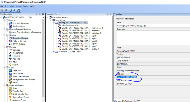

the problem is that you separate between the camera to the hardware.
configAccessViaSDK, what i get:
what i need:
On the PlaybackWpfUser sample explore the “IP” button.
A better way.
Do not use the IP address but use the GUID instead. Format the Analytics Event XML like this.
<Source>
<!-- Insert camera URI here, if you don't have the GUID. -->
<!-- (For multichannel devices, URI may contain channel number after ',') -->
<FQID>
<ObjectId>
F62D32D1-B02A-49BF-A429-753338A5E820
</ObjectId>
</FQID>
</Source>
