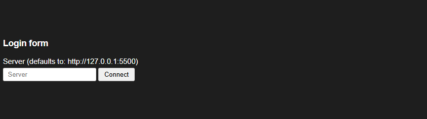

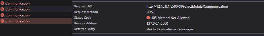

Hi, we are trying to rebuild some of where components from WPF to Web app (React), I was looking for way to handle video playback and live stream in web and I found out that you do have JavaScript SDK (but there is no documentation) and I found this GitHub repo that have web samples of handling similar stuff, but when I tried to run them on my machine, in the connect step i got 405 Method not allowed:
so if you can provide documentation of how to use it and please if you can help me with this error
Thanks for helping
Hello Abaas,
A great place to start is the MIP SDK Mobile Documentation. Navigate to the Web tab, then click on How to Host a Sample in the top left corner. There, you’ll find instructions on setting up your MobileServer and hosting samples. A simple way to create and work with your own samples is by setting up an Express server.
Let us know if this helps
Hi @Constantina Ioannou​
Thanks a lot, that was super helpful.
