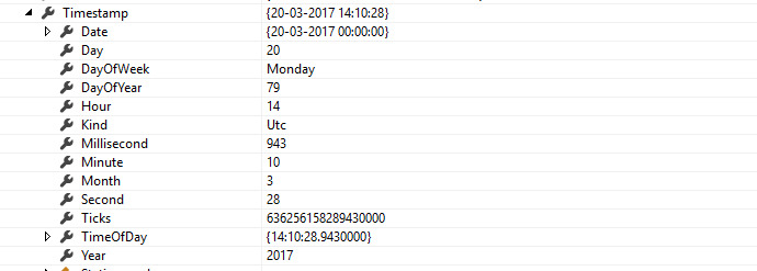

The snapshots are a few frames off, milliseconds in time.
The eventheader.timestamp provides the time of the event in hh:mm:ss, but no milliseconds. Is this correct?
I think that this is my problem, the GetAtOrBefore or GetNearest need milliseconds to get a accurate frame.

My test setup is all 2017 R1. I get milliseconds..
My guess is that this is not changed in the versions between yours and mine so please double-check your code. Let us see it if you do not detect something that explains it.

I’ve checked the code and saw that I missed the milliseconds :slight_smile: A test is running as we speak.

Still no correct images… If I directly send the Timestamp value to the GetAtOrBefore, do the milliseconds include? Or do I need to construct a new DateTime object that contains date and hour:minute:second.millisecond?
