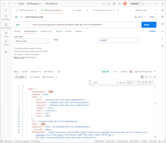

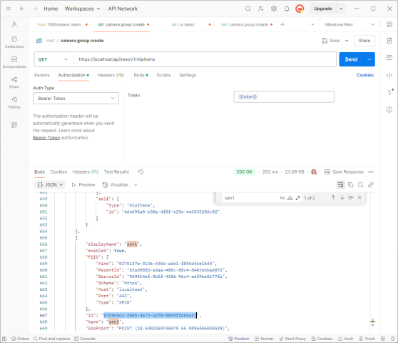

I am guessing what you are doing is equivalent to this…
As you can see it works for me.
If I haven’t guessed wrong what you are doing, it might help your troubleshooting already seeing this.
If it does not lead you to a solution we need to get more information about what you are doing.
