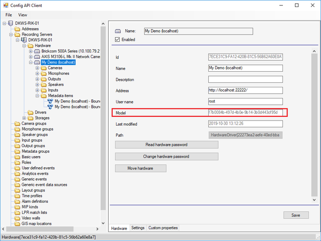

The parent for the Metadata item is the Hardware item, I think the properties here can identify the item as being based on your Driver Framework driver.
This screen capture was made using the Configuration API Client sample -
https://doc.developer.milestonesys.com/html/index.html?base=samples/configapiclient.html&tree=tree_2.html
