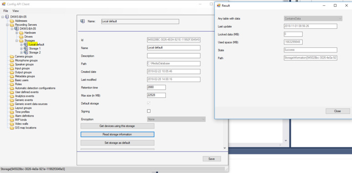

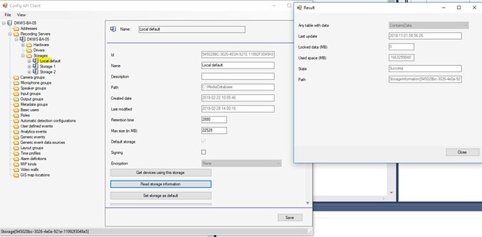

You can get the used space using the Configuration API.
If you use Config API Client sample you can see it here:
I suggest you find FPS setting in a similar way in the Config API Client sample. Hopefully you will be able to find the right one..
