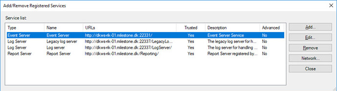

As the error mention the Registered Services, verify it is correct.
Management Client → Tools → Registerer Services, see following image.
The AlarmClient is hosted by the Event Server. Please troubleshoot if there are networking or firewall issues that might affect the network communication with the Event Server.
