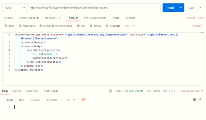

GetConfiguration Soap in server command service thru http
HI Miletone,
I tried to get the configuration via below Soap with Basic Authorization.
https://localhost/ManagementServer/ServerCommandService.svc

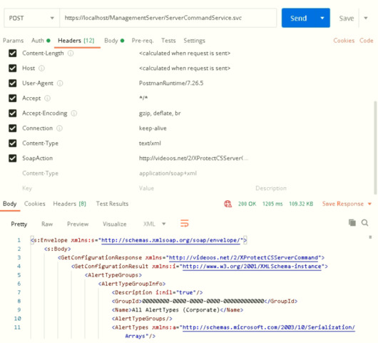

I found it works thru HTTPS but when I change to HTTP, the 400 bad request.
Is there anything I missed?
Attached the snapshot
posted a file.
For basic users HTTPS must be used. If you want to use HTTP request, then you will need to use AD user, please see this page –
https://doc.developer.milestonesys.com/html/index.html?base=gettingstarted/intro_soap_protocols.html&tree=tree_3.html
Got it, thanks
