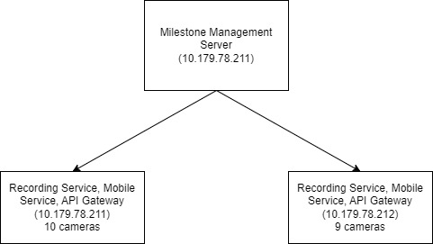

I setup Milestone in two servers as picture below. One Management Server and two Recording Server.
One master server (10.179.78.211) setup : Management Server, Recording Server (10 cameras), Mobile Server, API gateway and another (10.179.78.212) : Recording Server (9 cameras), Mobile Server, API gateway.

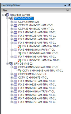

The problem here is that I can only get status of 10 cameras in same Management Server and Recoding Server, and get null with 9 cameras in another server.

Only guid cameras : 4a7f1bfa-7b7a-4a98-af72-2944262f020d, a6b33cb7-6580-4de9-a188-9fb168c2ca7e from Recording Server same with Management Server return result.

The RecorderStatusService is on the recording server, you should never use the URI of the Management Server to contact it. When you get the configuration from the Management Server each camera will include information about the Recording Server URI, this is what you need to use instead.
In a large installation you would typically have one server with the Management Server service but no Recording Server, and then have up to hundreds of Recording Servers.
In your example there is a RecorderStatusService at 10.179.78.211 and 10.179.78.212 (basically everywhere there is a Recording Server).
