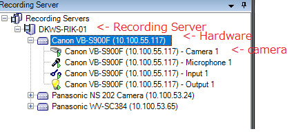

You might think that the “hardware status” is the status of the recorder PC, not XPCO hardware, this is not so.
(Please see below picture, you might already know this but let me explain.)
Thanks Rie. What is the correct command to get this info for the Recording Server then?
If you get any sorts of reply on this status API then you know the RS is running. Is this what you need?
